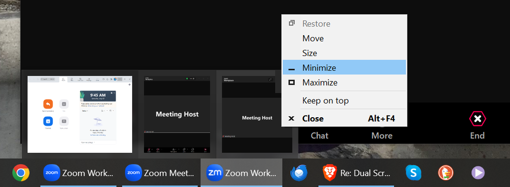

We leave Use Dual Monitors checked.....Before the meeting starts we make sure the 2nd Zoom screen(the one showing the stage and participants) is on the TV's and is maximized. Then in the Taskbar I put my cursor over that 2nd screen thumbnail and when the small preview window appears I slide my cursor up in the preview, right click to get the menu and left click on minimize. The 2nd screen gets pulled back to the Taskbar of the PC monitor. Leave it there until it is time to show that 2nd screen for someone giving a talk on Zoom. When its time for a part over Zoom I remove the spotlight for the stage and I reverse what I did earlier.....slide my cursor over the thumbnail again, slide it onto the preview window, right click to get the menu and left click on Maximize. When that part is over minimize the window again, put stage spotlight on again and click on thumbnail for Year Text.
Now when Zoom decides to take over the 2nd screen, which usually happens during a song, it only shows a black screen and we just quickly click on the JWL thumbnail to bring it back.
With a little practice it can be done very smoothly.

I have screenshots of what we do but unfortunately cannot upload them.
