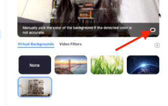

If you want to continue using VB with a green screen, which is appears you don't have behind you, you will need to edit the color that the Zoom client is replacing with your VB. Right now its set to replace the color of your face, but if you click the small color box (shown below) and click on the color you want to replace in the video preview, Zoom will begin replacing that color instead of your face.
As @LucaPaleari mentioned, you can also just disable VB with a green screen, so that you don't have to worry about the color matching.
