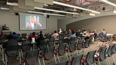

We used several OBSBot 4K PTZ cams strategically positioned around our auditorium to capture in-person audience questions during a Q&A at the end of a presentation; we had a presenter station at the front of the room, and an additional assistant PC station at the back of the room (POV) to adjust the OBSBot cams as needed. We remotely changed the position/zoom of the closest camera to the attendee, and then used the spotlight feature to highlight them from the assistant station's Zoom screen when they needed to be featured.
