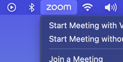

2023-01-03 02:01 PM - edited 2023-01-03 02:09 PM
I would also like to be able to switch back. The new menu bar icon is unnecessarily large and takes up way too much space. Here's some screenshots showing the icon next to some normal sized icons, not sure how you can't see the difference @YaBoiB, it's nearly twice as wide. The old icon (the camera) was roughly the same size as the wifi or bluetooth icons here, and it fit in much better.

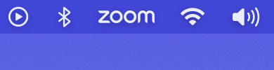

2023-05-24 09:09 AM - edited 2023-05-24 09:11 AM
This is excellent, I had some finickyness with resizing, note that the 2x.png has to be exactly twice the size of the menu_tray.png file, so in my case, it was 9px by 8px, and therefore 18px by 16px in the 2x file. It got grumpy when they weren't perfectly matched, but I love this hack! I recommend keeping a copy of your cropped images, so that if Zoom updates, and puts the big one back, you can quickly copy them back in again, like:
# Assuming the cropped images are in ~/Desktop/zoomicons/
sudo cp ~/Desktop/zoomicons/menu_tray* /Applications/zoom.us.app/Contents/Frameworks/zMacResRetina.bundle/Contents/Resources/
Here is what it looks like now!
