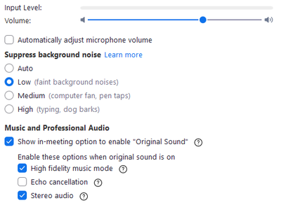

There are a few things you will need to do:
1) Set your Audio Settings like this:
2) When you are in your Meeting, look for the Original Sound button (top left) and turn in ON:

Hi @Fred-Steen
I have Produced some high-level in Events in Zoom with excellent sounding audio, with the settings I have described. Background noise suppression cannot be disabled completely - it can either be set to Low or Auto - but enabling Original Sound with High Fidelity and Stereo modes on - and making sure you activate Original Sound actually in your Meeting - should all do a fine job at passing good quality audio into your meeting.

I host and participate in a couple of musical open mics. We've had this recurring problem of certain instruments and musical styles creating distortion, sounding similar to a bad phase shifter. We started with the usual "Turn on Original Sound". Open audio settings and shut off Echo cancellation. After much fooling around with the audio settings in Zoom, we discovered the culprit at least in Windows 10: the Windows audio drivers are conflicting with the Zoom settings. If you go to the bottom of the audio settings page, there's an "Advanced" link. Click. Then you'll see "Signal processing by windows audio device drivers" with a pull down window that we be showing the default "Auto". Use the drop down menu and select the "Off/Raw" setting. That solved it for us. I don't know why Zoom's default isn't the "Raw" setting, since this conflict is affecting so many meetings. Since this same thing happens when Zooming with Apple products, I assume there's a similar culprit there.
