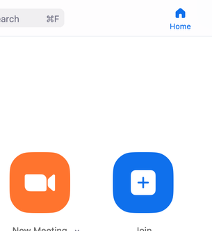

Hi @mewtenantworf thanks for your post on the Zoom Community! Ok, if this has happed due to a recent update do you know what version you updated to? It could be coincidental but I can check the version to see if there are any known issues. In your Zoom client, just click your picture in the upper right and select "Check for Updates." It will tell you your current version and update the client if you are not on the latest.
Next, why don't we try to isolate the issue to which audio source you are using and which one is causing echo. In your Zoom client if you click on the "Home" icon at the top
Then click the Settings "wheel" in the upper right, this will take you into your Zoom client settings. Click "Audio" on the left.
