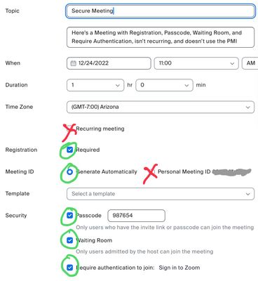

One approach that will help is to require registration for your event. Put the Registration link on Meetup, and any other public-facing sites. This alone will ward off some people with bad intentions. Unfortunately, anyone can register - even the bad ones. If you know your usual attendees, you might be able to figure out which potential new attendees might need some extra attention during the initial parts of the meeting.
A second additional step would be to enable Require Authentication on your meetings. This means every attendee must be logged into their Zoom account in order to enter the meeting. It shouldn’t be a barrier for anyone’s participation – anyone without a Zoom account can sign up for a free (Basic) account.
Another point: don’t use Recurring Meetings for your group. This re-uses the same Meeting ID and therefore the same Join link. Having a different Meeting ID and Join link every time with ensure that nobody can get access that will continue over time – they have to find the new link each Meeting. It might be a little inconvenient for some people, but I’m sure if they find your meetings informative and helpful, they’ll make the effort.
Here’s how I would set up a meeting for maximum security:
Finally, any time you have a problem attendee, use the features of the Zoom Meeting app to remove them from your Meeting, and afterward follow up with a report to Zoom’s Trust and Security group.
