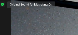

I am having this very issue as well. Have you enable Original audio in your account and then also while on "the call"?

I don't know if you have checked these but the original sound should be selected as well as going into setting enhancements on your computer settings. For me I have a Mac pro, which has no enhancements, so I went to Apple Music and turned on the equalizer after selecting from the menu. I selected more treble, but there are more settings. I also unchecked automatically adjust mic. We shall see tomorrow. I already tried with 2 students, who said the sound was better.

In addition to ensuring that original sound is enabled in your settings AND while you’re on each zoom session (typically upper left hand corner), check to see if your Windows 10 device has an app called Bang & Olufsen. It is an audio control app. In the noise cancellation tab, ensure that noise removal to input and output device are off. This fixed it for me

Well I seem to have found the answer . You go to the audio setting
Once you click on the orginal sound on your problem should be resolved

Nope...although a nice presentation...it is not the problem if you have realtek on a laptop using window 11...still trying to figure it out.
2023-03-21 01:43 PM
You need to check the other boxes in musician's section and uncheck automatically adjust microphone.
