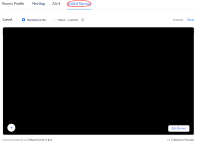

Hi, @MrEdL
Do you have a Device Operation Time setting?
Another way, you can use Digital signage.
Registering black images as signage content and playing them back would prevent TV burn-in.
