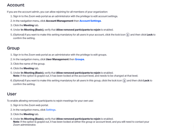

Hi @organizer4u
Please make use of the terms -
Allowing participants and panelists to rejoin (zoom.com)
Hope this helps - Happy to help further!!

2024-04-03 11:05 AM
I turned on "allow participants to rejoin" - but it says (below) that they cannot rejoin the current meeting with the same email .... which would be a problem.
It also says that the session must be stopped (therefore throwing everyone else out) and restarted again - which would be a problem.
Am I interpreting this correctly? I just want them out during the break and to be "re-admitted" after the break - without affecting anyone else or having to close ouf of Zoom and restart the meetings.
By default, if you remove meeting participants, webinar attendees, or webinar panelists from the live session, they will not be able to rejoin the session using the same email address, but will be able to rejoin a future session. If you would like removed participants to be able to rejoin, this behavior can be changed, but the live session will not be immediately impacted, as it will need to be stopped and restarted before the change is recognized.
2024-04-03 11:25 AM
Hi @organizer4u - Can you please explore a bit from these options and see if that solves -
2024-04-03 11:34 AM
I did that (so hopefully it works at our next meeting).
But - can the person be readmitted without having to close out of Zoom & restart the meeting - or not? Which is what it says below.
2024-04-03 12:56 PM
Hi @organizer4u
This means that if you enable this option during an ongoing session, participants who are removed won't be able to immediately rejoin using the same email address. You'll have to end the current session and start a new one for the updated setting to take effect.
Accordingly, it should fix the issue for you next time.
Warm Regards
