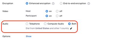

Hi @EDDA
Looks like you scheduled the meeting with just phone audio, which means that you cannot use your computer audio and removes that option. To fix this meeting or avoid this issue when scheduling another meeting, make sure the Audio Option is set to either Computer audio or Both:
This article has more information about how to scheduled meetings: https://support.zoom.us/hc/en-us/articles/201362413
Hope that helps and let me know if you have any further questions. Otherwise, make sure to mark the solution as accepted if this information is what you needed.
