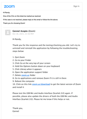

Please help. Problem only started a couple of weeks ago. My USB Mic or Audio Interface Mic would not work properly. It is either jittery or garbled. I could not even get clear audio when using mic with Audio Interface. This has not happened before but issue only started a couple of weeks ago. iMac Pro running macOS Catalina 10.15.7. Zoom version 5.8.1.

Thank you for the suggestion. Support gave me a solution to try out that worked.
