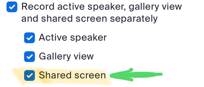

The Cloud recording is controlled from your Zoom Web Portal at https://zoom.us/profile/setting?tab=recording in the Cloud Recording section. Look specifically for this highlighted setting, which will create a separate MP4 with a clean share-only view.
Just above that are two other options which, if unchecked, should remove any overlay of the screen share by a speaker.
