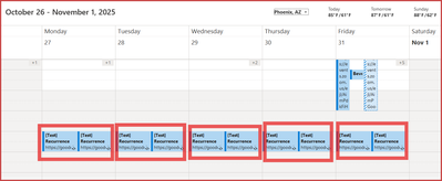

I’m wondering if it’s possible to copy/paste an occurrence – either in the Workplace app or an external linked calendar (Outlook or Gmail) – which may or may not link up to the original series and create a new occurrence. I can’t test that at the moment, but you might try setting up a “test series” of a few sessions and see how it works.

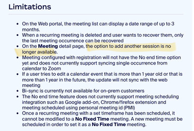

While researching this, I did find an entry in the Limitations section of this support article (https://support.zoom.com/hc/en/article?id=zm_kb&sysparm_article=KB0064248) which reads:

When I got to my desk I tried selecting one day's occurrence in my Outlook calendar, copying it, then pasting it into another day. It doesn't work... it actually pastes in another complete set of the original occurrences next to the original ones:
2025-10-25 05:45 AM - edited 2025-10-25 05:46 AM
@Ray_Harwood : Thanks for the reply. Yes, I agree that the copy paste doesn't work.

I was hoping that someone would be able to tell me how to get back that "Add another session" button. I find it incomprehensible that Zoom removed it (I've used it in the past, but probably not for over a year).
