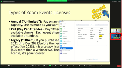

Sorry, @Librarycat.  I think you're missing the point.  Look at this test-share screen shot which also includes the Statistics tab showing the sent and received resolution of the VIDEO (which is the two attendee images on the right side):
These images are NOT HD images -- meaning they are not 1920x1080.  They are scaled down versions of the best image needed to fit the space occupied by each image, which in this case is 320x180.

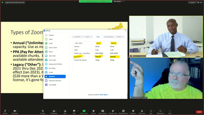

Note that if I move the vertical bar to the left, the images get larger, and Zoom "scales up" the sent and received video resolutions as needed:
You'll note here that the received video resolution is now 640x360, since that is the size needed to fill the space.  But notice that the sent resolution remains 320x180, since all of the other recipients still have the initial side-by-side gallery view (with images sized like the first image above), and don't need any more resolution than they're already getting.  Zoom will not ask this client to scale up it's sent video resolution, in order to reduce the bandwidth needs with all attendee's viewing states taken into consideration.
