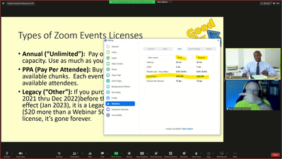

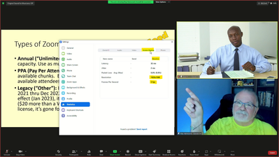

    Zoom bandwidth utilization is very adaptive – you shouldn’t need to manually revert to SD (if it was possible – which I don’t think it is). If there are participant devices with great throughput, their video can be sent to Zoom servers at HD, and if Zoom determines any recipients don’t require or can’t receive the bandwidth it has, it will “throttle down” the outbound video individually as needed. For example, 8 attendees are watching Gallery  View and 2 attendees are watching Speaker View with one spotlight (or none). HD will be sent to each of the latter 2 if their bandwidth can support it – individually. The ones watching Gallery View will receive SD (or lower!) resolution. Check out the resolution sent and received by your machine by viewing the Settings Statistics tab, cycling through the various displays.
    Note that Shared Screen is always sent at the native resolution of the source, unless bandwidth issues require throttling. Any presenters sharing 4K screens are far more likely to cause issues than your attendee camera videos.
