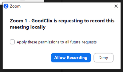

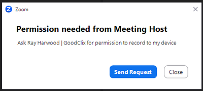

The prompt you saw was from a participant who initially clicked the Recording button, which then prompted the user with this prompt:
They then clicked "Send Request", you got this prompt:
... where you clicked "Allow Recording".
What has happened here, since the participant was not the host or co-host, is that their only possible permission to record would be Locally. Only the Host and any Co-Hosts can initiate a Cloud recording, which is always stored in the Cloud under the account of the meeting's owner.
So when you granted permission to record, the user clicked the Record button again, which initiated the recording Locally on their computer.
