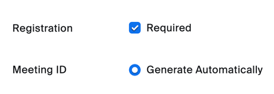

@ngp30 - From the Zoom web portal, go into your meetings and click on the 'Schedule a Meeting' button in the upper right. When you do that, down near the meeting id, there will be a checkbox to require registration which you need to select.

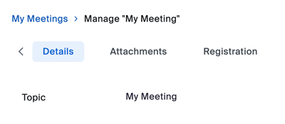

Once you save the meeting, you will land on a confirmation page which should have the 'Registration' tab at the top.
