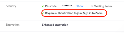

Hi @TuanAnh85
If the report is missing their email addresses, it generally means they were not signed-in to their account when they joined.
To ensure that everyone that joins is signed-in, you can edit the meetings and enable Require authentication to join, located in Security options. If that option is not enabled, participants will be able to join without being logged in and thus no email address will be captured in the report.
Keep in mind, if you change settings on the Settings page, that will be the new default when scheduling new meetings, but has no effect on already scheduled meetings. To change the behavior of an already scheduled meeting, you need to edit that meeting itself and change the settings there.
