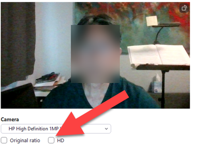

2021-08-21 03:30 PM
I have discovered that unchecking the HD checkbox under the Camera settings makes the vignetting go away.
2022-03-04 10:01 AM
I cannot find the screen shown in this Solution. Could someone please give me a step-by-step process for my laptop Windows 10? Thanks so much!!
2022-03-04 11:08 AM
A couple ways to do this:
1) without starting a meeting, click on the gear icon under your photo to access Settings. In Settings, select Video on the left column. On the right side of the screen, the HD checkbox is under your video window.
2) start a meeting. Click on the up arrow next to the Start Video icon in the lower left corner. This will take you to the same Settings area as above.
