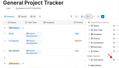

If anyone can help me, i had a issue with a table in Zoom Docs. I created a table with some columns, but one of these were not seen by my job partner. At the next day, this column just had disappeared. If I try to create the same column again, the alert is displayed: "Enter a unique column name".
I did something wrong?

Hi @mborges-mpf , could you check if there are any hidden columns in this data table? Attaching an example for your reference:
