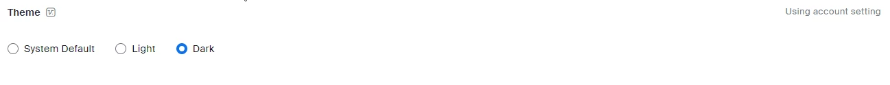

I've set the theme in the global account settings as well as on each zoom room setting as well and I've also completed reboots of the zoom rooms but they still remain in light mode. I've attached screenshots of the theme settings I've set to verify this is set to dark mode.

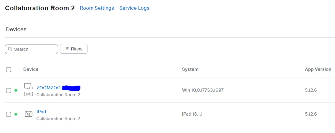

    CounoTechAuthor
    Nov 22, 2022 11:52 AM UTC

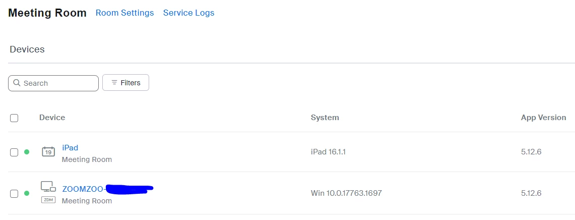

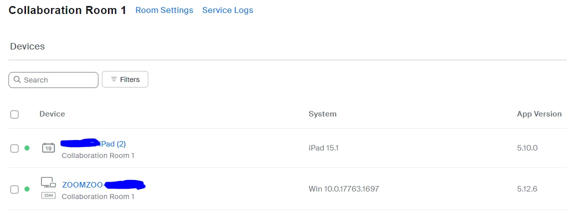

    Thank you.  Image attached.
    Nov 22, 2022 1:18 PM UTC
    Thanks.  The iPad itself is where the issue is as that is only on v5.9.4.  Check on the iPad is you can upgrade the Zoom app via the App Store.  It should indicate that there is an update available.  When that is done you should have the dark mode being applied.

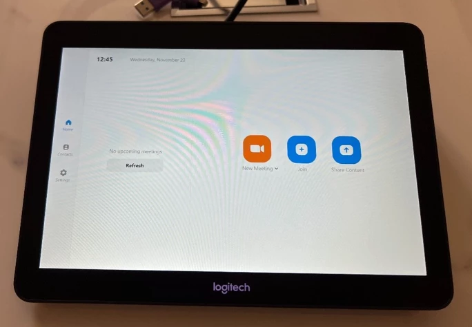

    The client has advised "I have updated the Zoom controller App on the iPads of Collab rooms 1 and 2, meeting room and library (board room is being used at the moment and cannot be accessed), and the tablets in the rooms are still in white."
    Images attached.
    Nov 22, 2022 5:06 PM UTC
    That should have upgraded to v5.12.6 which is the current version.  I see it only went to v5.10.  Dark mode is only supported from v5.11 and upwards on the iPad as a controller.  Is the iPad maybe on some sort of MDM or something?  I don't have and iPad with that specific IOS version to test with but you may also want to make sure the iPad is on the latest IOS version.
    We definitely need to get to the correct app version on the iPad to resolve this.
    You can see on this link the latest is:  v5.12.6. Zoom Rooms Controller on the App Store (apple.com)

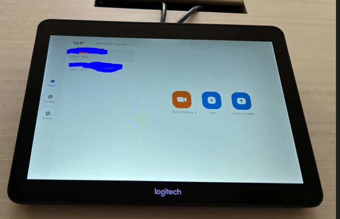

    final image from previous update
    Nov 23, 2022 1:13 PM UTC

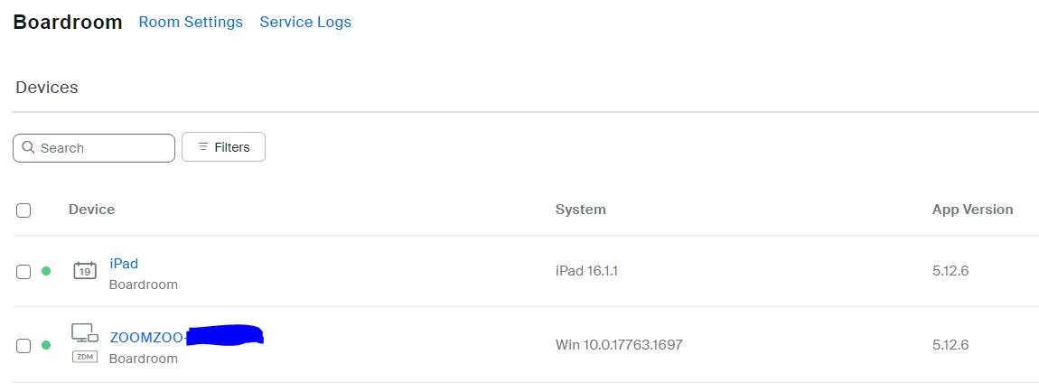

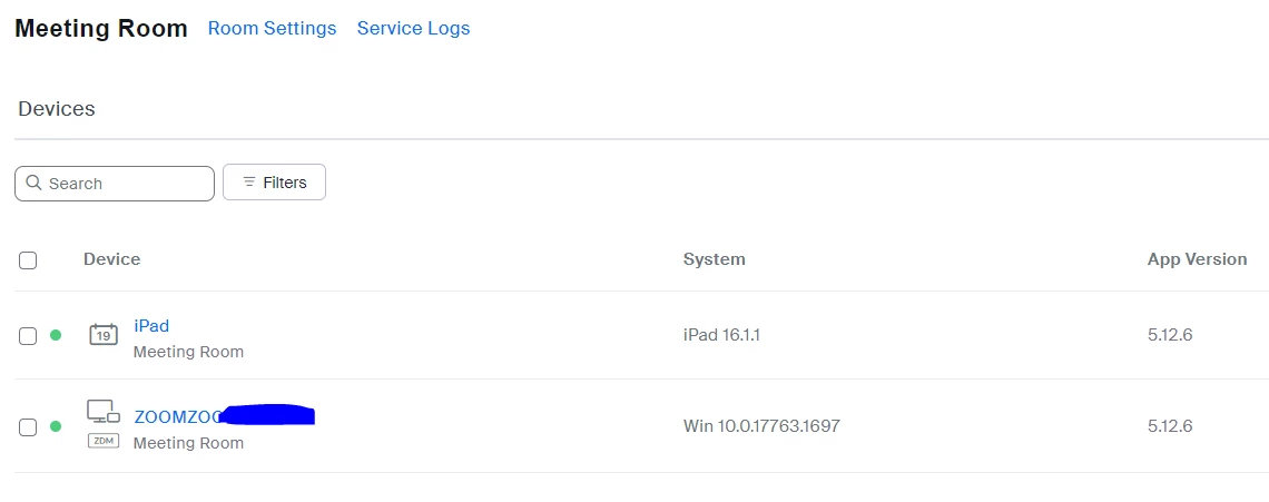

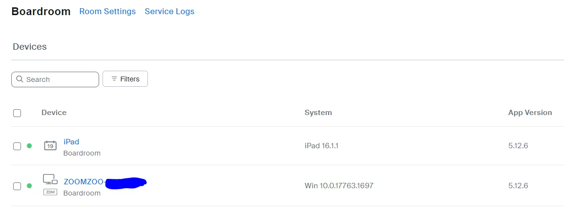

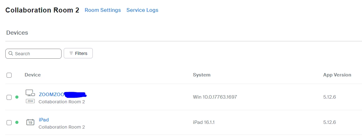

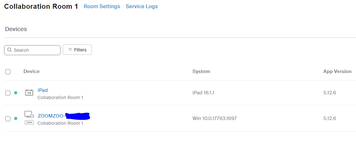

    that still looks like the previous version.  Can you check on the Zoom Admin portal what version it is showing?
    CounoTechAuthor
    Nov 23, 2022 4:23 PM UTC
    sorry i thought i had included those.
    Here they are

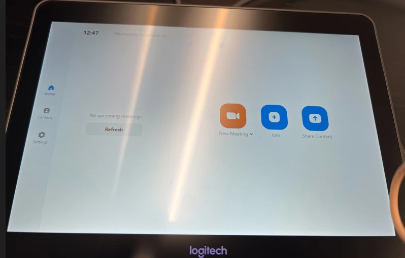

    Nov 24, 2022 1:11 PM UTC

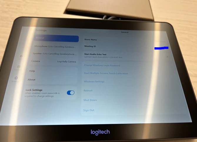

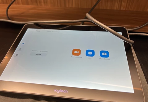

    From the client
    This is the boardroom tablet, and I have also checked all the other devices and they all look the same.

    @CounoTech I need to get some clarity here as this might be the issue.  The screenshots you previously shown me on this thread stated iPad as the controllers.  But the new photos you shown me of the controllers are actually Logitech and those look to be USB based to a Windows Room.  Is that correct?
    If so, the iPad controllers should now already show dark mode as that is supported today.  The Logitech via USB mode to Windows based Zoom Rooms is not supported right now.  This should change really soon but I can't give any dates on this.
    CounoTechAuthor
    Nov 29, 2022 4:00 PM UTC
    Apologies for any confusion.  The controller is the Logitech and the iPad shows the free busy times.  the controller goes into a Hub.  We have a similar setup with a Logitech and dark mode works without issue 🙂
