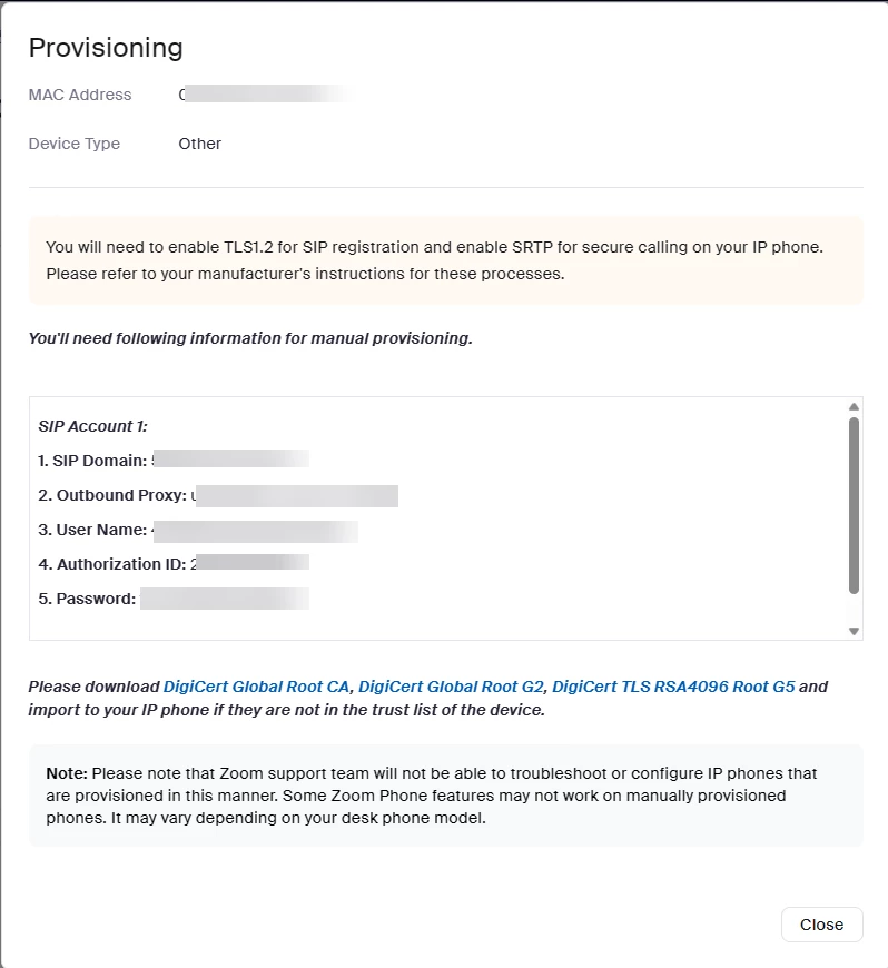

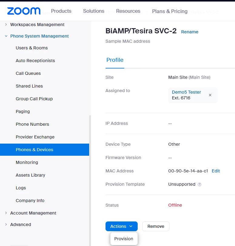

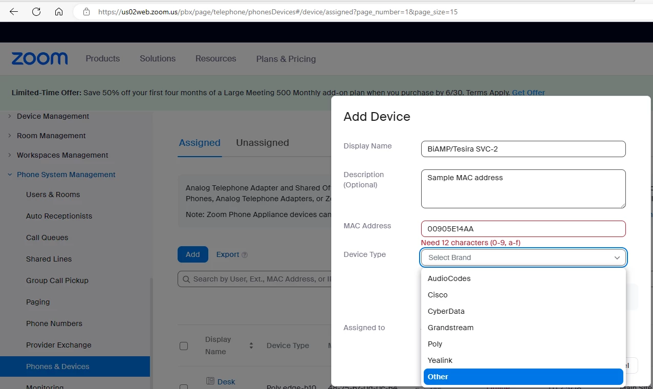

    hi jaron,
    1.  if you want to try provisioning your biamp svc-2 card, you will need its mac address.
    Finding Tesira MAC addresses - Biamp Cornerstone
    2.  make sure that required certificates are in place.  see provisioning screen shot.
    3.  add a zoom user with an extension to be used with biamp svc-2, add this zoom user as a zoom phone user.  if desired, assign a calling plan for external calls.
    4.  add the biamp svc-2 as an Other Device type.
    phone system management->phones & devices->add device other
    phone system management->phones & devices->save add device other
    phone system management->phones & devices->provision device other
    phone system management->phones & devices->provisioning
    5.  the provisioning screen will provide the sip credentials for your biamp svc-2 with the mac address you specified including:
    1.  sip domain
    2. outbound proxy
    3.  user name
    4. authorization id
    5. password
    6. configure the biamp svc-2.
    Using TFTP to provision Tesira VoIP cards - Biamp Cornerstone
    thanks,  eliot
