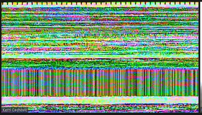

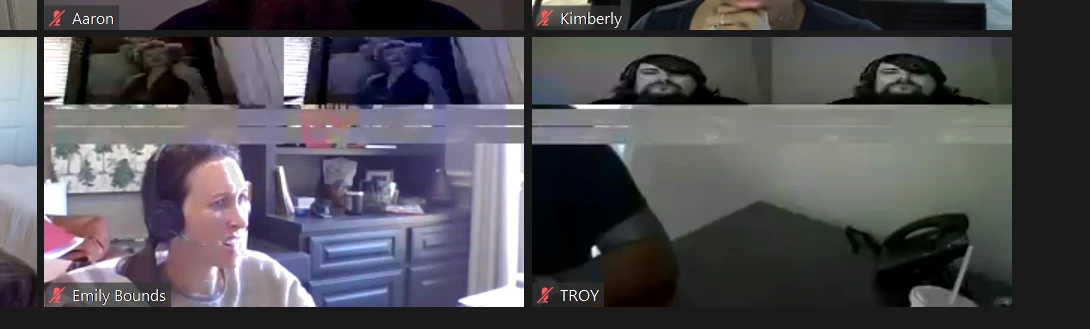

    My office is having the same issue. Zoom Support is no help! See attached photo. Is this what yours is doing?
