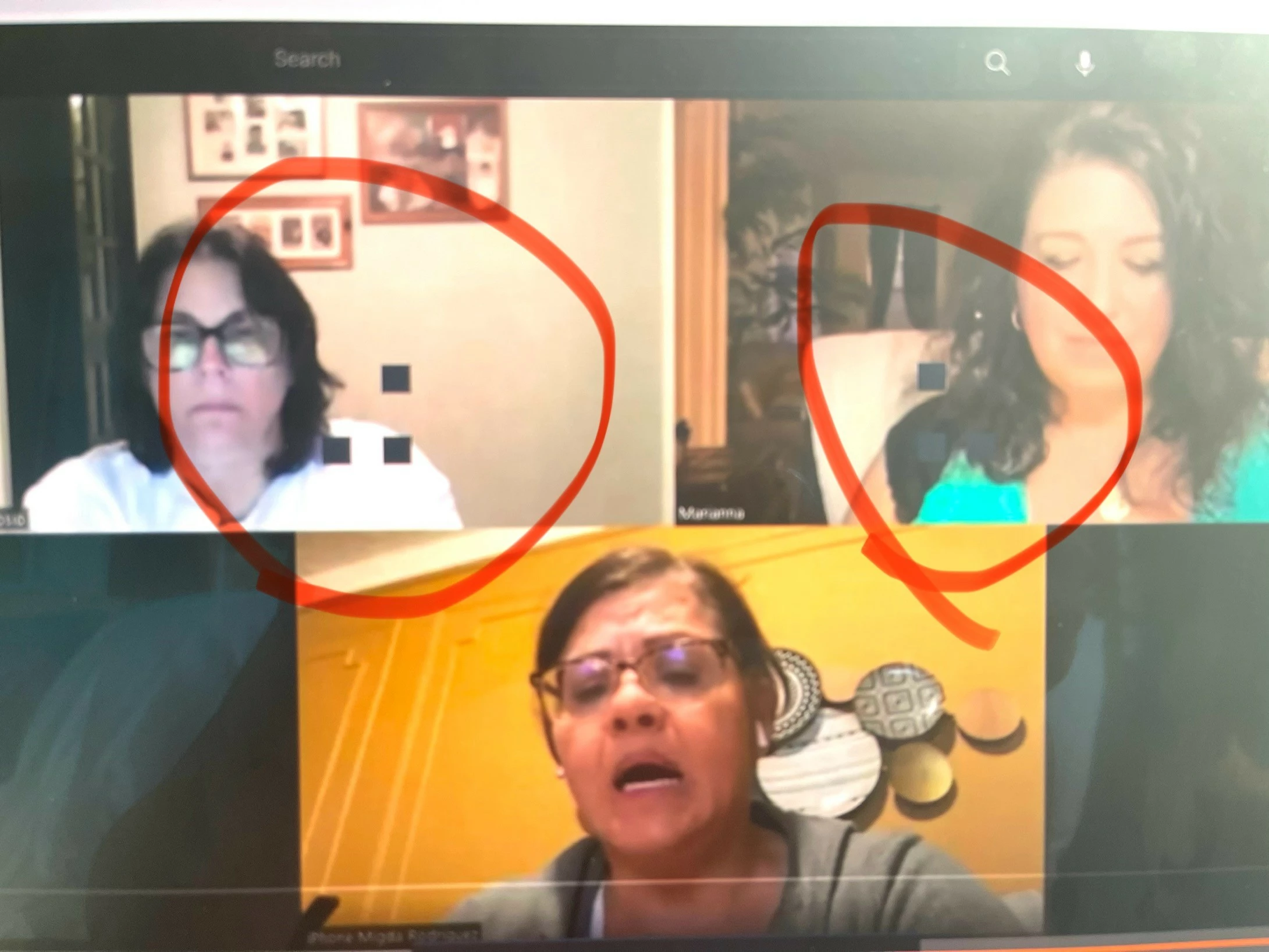

when I host a Zoom meeting and start a screen share, the participants always see a black bar at the top. This is the zoom bar for me. Even if a pop-up window appears that another participant wants to join the meeting, the other participants see this as a black box. I've attached an image as an example. I've already looked through all the settings, updated the Zoom client, but I just can't get this to go away. I work on Windows 10 Pro. Can someone help or give a tip here? Thanks!

    I have tried this, it is not correcting the issue.   It does hide the control at top, but I still have block boxes in my video.  see the image below.  there are 3 squares in the middle of the screen. on the left and right.
    The control at top and the CC box seem to go away.    I will try again to be sure.  But optimizing video option causes all of this.   An unintended consequence I guess...
