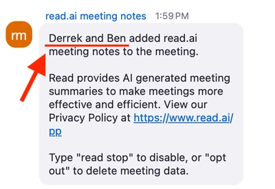

    Hi everyone,
    It's possible that someone invited to your call has enabled Read. They don't necessarily need to attend the meeting; just being invited is enough. Read can only join if a Read user invited to the meeting adds it.
    Each meeting platform supported by Read has a built-in chat function. When Read joins a meeting, it sends a message to the chat that looks something like this:
    If you see your own name listed, it means you have a Read account. In this case, you should:
    1. Search your emails for messages from support@e.read.ai, such as the "Welcome to Read!" email sent to new users.
    2. Check the primary email address of your Read account in the "to:" line.
    3. If you have multiple email addresses, check all your inboxes.
    4. If you used single sign-on (SSO) like Microsoft or Google to create your account, try logging in using those options if you're unable to with your email and password.
    As mentioned in some comments on this thread, you can also type in the chat read stop to disable read ai or opt out to delete meeting data.
