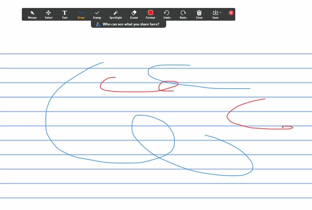

    This could be achieved by Screen Sharing + Annotation, rather than Whiteboard itself.
    • Find yourself (or create) an image with a lined background.
    • View this image full screen, or in a Window.
    • Share Screen in Zoom - of either your Screen or just the Window (with the lined image).
    • Turn on Annotations
    • That gives you whiteboard-like features over your lined background. Shared by default.
    See below. Is this what you are looking for?
