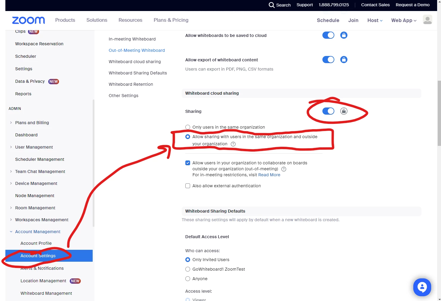

  1. Ensure "cloud sharing" is enabled and set to include external users. Account settings -> Whiteboard -> Cloud sharing:

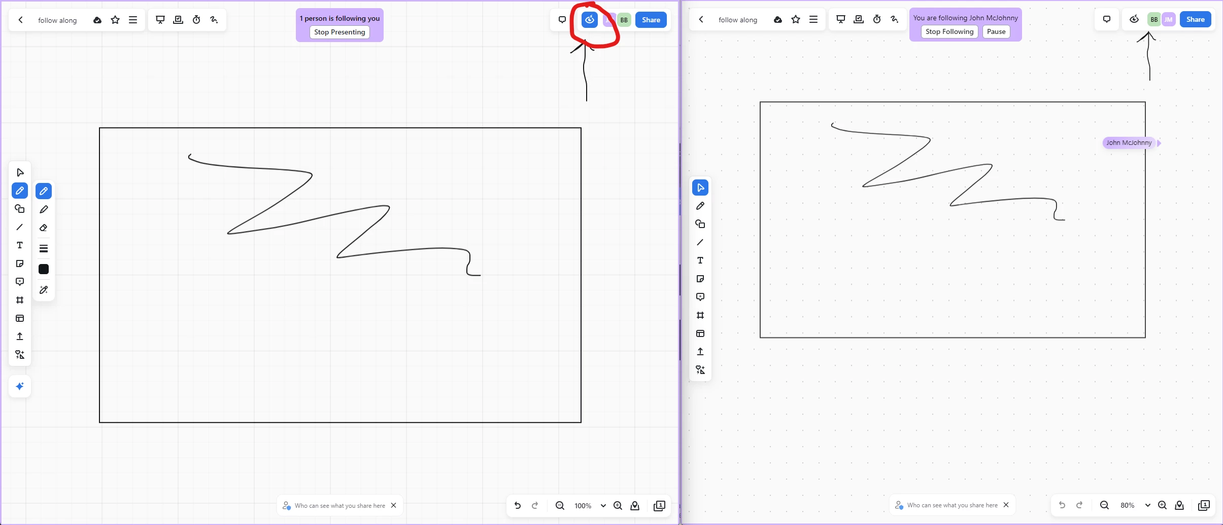

  2. To have other students follow you, click on the "follow along" icon in the top right corner of the screen to make everyone follow you as you present:
Does this help at all?
