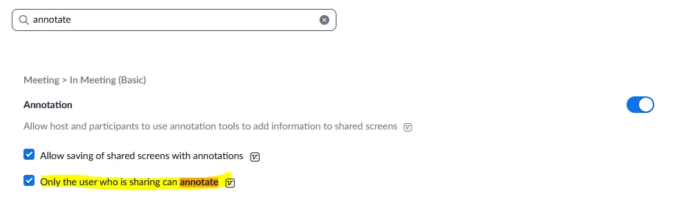

I am just starting out as an online teacher.  I am having trouble, as when I share a whiteboard, my students are not seeing the option to annotate or write on it. I can write and draw on it, but they just get a blank whiteboard with no annotation tools.  I have tried everything.  The settings are set up for students being able to annotate.  Really could do with a solution.

    Can you please check to see if you have "Only the user who sharing can annotate" turned off under your meeting settings in the web portal?

    Thank you so much for your reply.  I have checked that "only the user who sharing can annotate" is turned off. It definatley is. So still got same problem ? driving me nuts.

    Here is a guide to using the annotation feature, please review it and ensure you are not overlooking a step. Also, note the app version requirement. If your students are not using the Zoom App with the version stated or a higher version, they will not be able to use the functionality (this includes joining from a web browser). I am assuming since the PWA for Chromebooks is not listed that it also does not support this feature.
