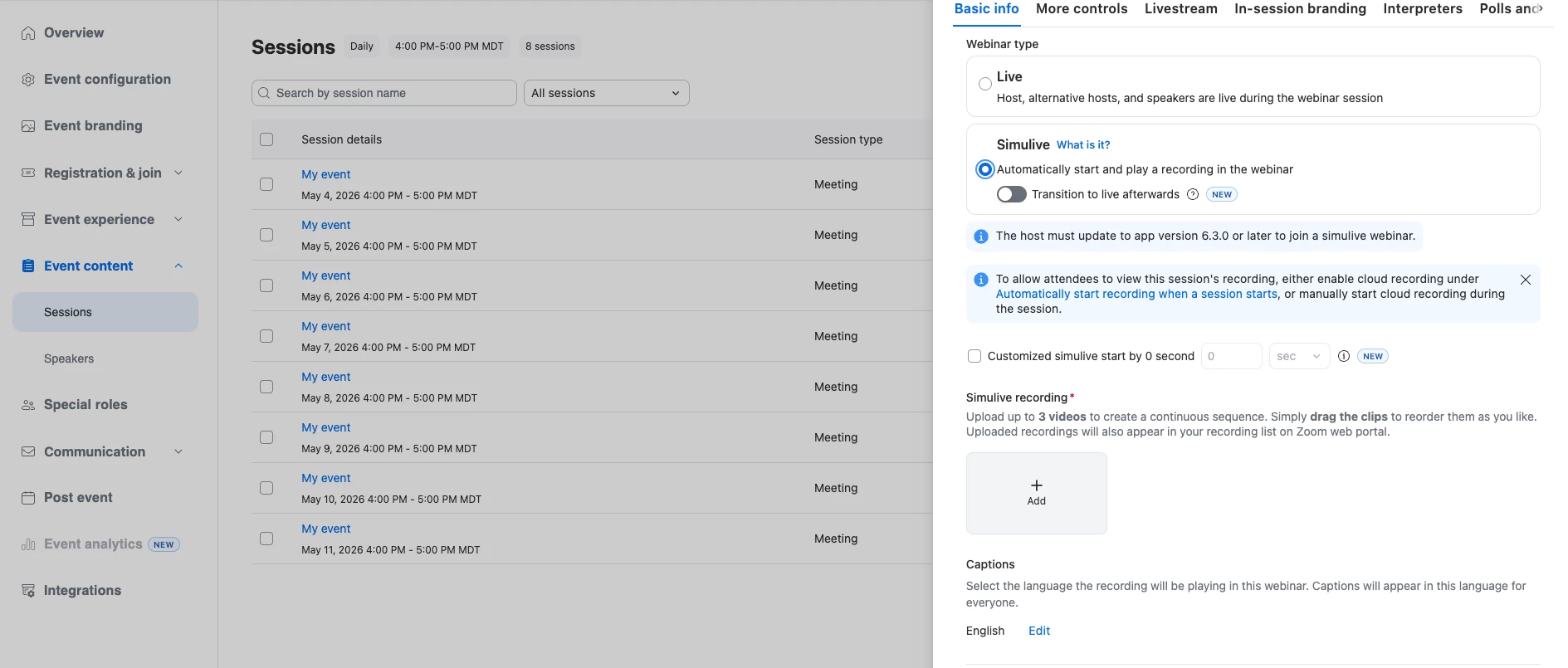

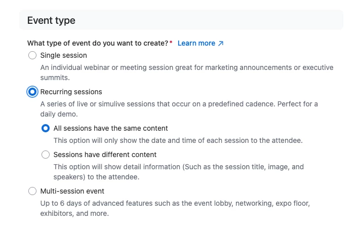

​@The Salon Suite Model yes, absolutely this is supported.
When creating the event, be sure to select the recurring event type. And once you’ve set up your sessions, you can adjust them to be simulive sessions under Event Content > Sessions

hi ​@The Salon Suite Model ,
Yes this possible. If you setup a recurring webinar, you can make it simulive, or maybe make the first one live and then use the recording from that to simulive all the future events.
