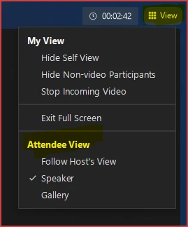

      • I always set the Attendee View to "Speaker".  When Attendee View is set to speaker, one or the other of these will be in effect:
        1. If there is nobody Spotlighted, then whoever is speaking will be shown on screen for the Attendees.  Though this also includes unmuted people who cough, have barking dogs, or family members/coworkers making noise.
        2. If there is anyone Spotlighted, they will be shown on screen; people not spotlighted will not be shown on Attendee screens.  You can Spotlight up to 9 people.  In order to Spotlight someone, their camera has to be on; but if they are Spotlighted and turn their camera off, their camera box will continue to be shown, either with their Profile Picture or their name, depending on a variety of settings. I always recommend Spotlighting those you want the attendees to see, and not spotlighting any other attendees.
      • You can set the Attendee View to Gallery.  In this case, the Attendees will see anyone whose camera is On.  Hosts and panelists with cameras Off will not be seen.

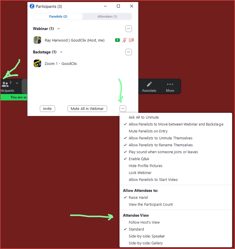

      • The settings are changed a little.  Other than "Follow Host" which I never recommend using, there is Standard, Side-By-Side Speaker, and Side-By-Side Gallery.
        1. Side-by-Side Speaker works like Speaker above. The shared content will be to the left of a vertical line, which each attendee can move on their own to see more or less of one side or the other; Spotlighted cameras will be seen to the right of the vertical line.
        2. Side-by-Side Gallery works like Gallery above. The shared content will be to the left of a vertical line, which each attendee can move on their own to see more or less of one side or the other; all cameras that are on will be seen to the right of the vertical line.
        3. Standard - I only recommend using Standard in one specific situation: if you are screen sharing and you to not want anyone's camera to be seen.  For NO camera to be seen, ALL host and panelists cameras must be turned off.  In Standard, if any cameras are on a camera or black panel will be displayed and overlay a portion of the shared screen content.  Even though the Attendee can move the camera image around, I don't recommend using Standard if you also want camera images visible.  Use the Side-By-Side view.

    • If you are the host and not screen sharing, the Attendee View menu is part of the View button in the far upper right corner of your Zoom display window.

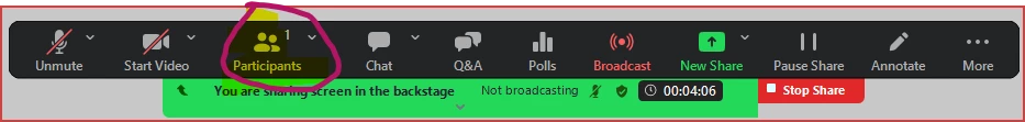

    • If you are the host and you are sharing your screen, the Attendee View menu is is located in the "More" 3-dot menu of the Participants window (click the Participants button in the floating green/red menu bar, the locate the ... button in the lower right corner of the Participants window).
      The Attendee View menu is at the bottom of the sub-menu that appears. (Technically speaking, the Attendee View menu is always available here as part of the Participants window, but it's a lot more convenient at the Host's View menu at the top rIght of the screen.)
