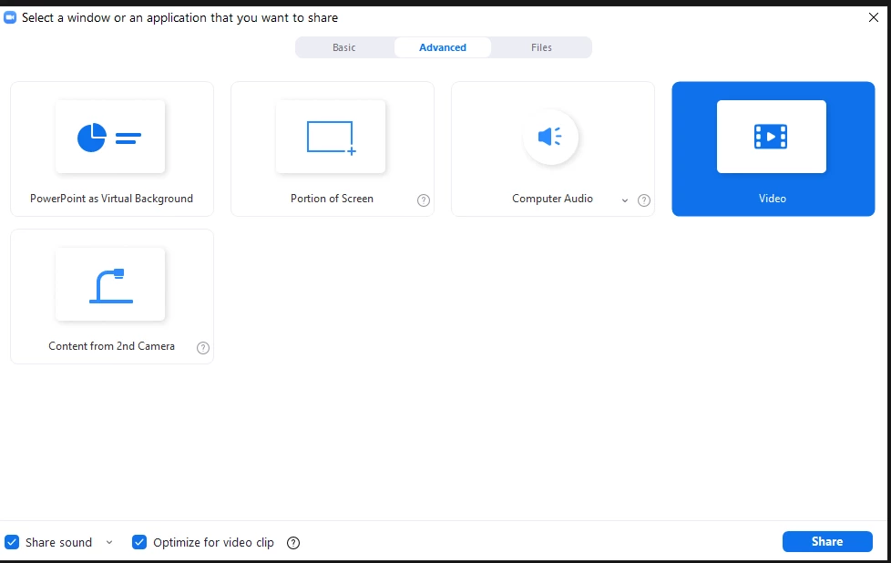

We've recorded a Zoom meeting for a session, on the day do I just share my screen and press play?  Is there an easier way?

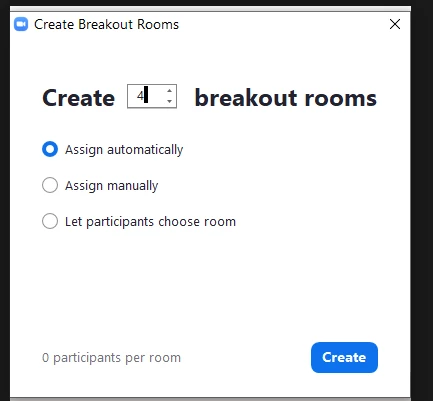

    If you are new to Breakout Rooms, I suggest you try it out in its many forms.  There are a number of options when starting them:

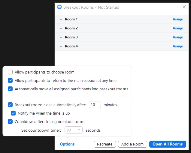

    And once you "Create" the rooms, there are more options:
    Seriously... get 3-5 people to join you for a half hour and investigate the options.  It's the only way you'll really understand how they work!  Day-of-the-event is not the time to be asking "I wonder what this option does?"

    The very best way to share a video is to use the Share Screen -> Advanced tab -> Video option:
    You need to press the Play button, and you should pre-test the volume level in advance.  I recently had a Webinar client give me a "pre-roll" video to play at the 15 minutes to go point... nearly lost my hearing when it started!
    Note: There are some formats that the Zoom player doesn't like... so try playing each and every one of your videos IN ZOOM before the event.  You never know who rendered them on what app with which codec.  If you find one that won't play, you can try converting it with VLC, or dropping it into Premiere Pro and re-rendering.
