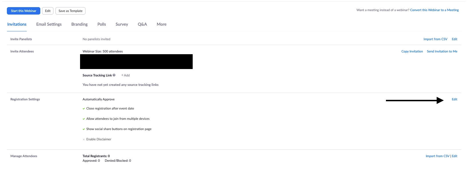

    @blasky The best way to ensure gatekeeping with Webinar registration is to have the option disabled to "Allow attendees to join from multiple devices."
    You can also do some gatekeeping for registration by setting approval to manual as well to ensure that you have to approve each attendee.
    After you create your webinar, click back into it from the webinar tab in your zoom portal and look at the bottom for the registration tab. From there you can edit the approval for attendees and adjust the settings we discussed.
