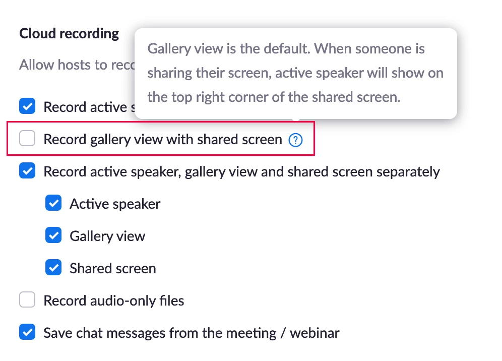

    May 16, 2022
    Fixed it by disabling "Record gallery view with shared screen".
    Apparently it's some kind of picture-in-picture "feature" that now screws with the layout:
    October 12, 2022
    this is exactly it
