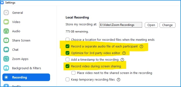

    Actually, I like having BOTH the Cloud and Local recordings... which unfortunately requires either two logins or having someone else do both.  Here's why:
    As some have observed, you can check an option when recording locally to record separate audio files for each participant.  This comes in handy when there is noise from participants other than the main speaker.

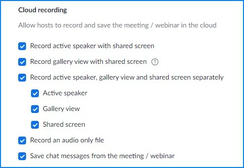

    But on the Cloud recording, you can set the options to record several video feeds:
    Now you have multiple views of MP4 files to work with (I'm using Premiere Pro for editing).  The downside of this is that it generates a LOT of HUGE files... you need to download them every day, and "delete" them so Zoom doesn't bark at you for over-using your quota.
    This multiple-set of videos is good... but not perfect.  There are technical ways to grab specific people, but as someone else mentioned, it typically requires additional hardware/software to do.
    I highly recommend trying the various options, doing some recordings, and examining the resulting files to see what's really there.  Note: When testing, remember that Zoom video display and recording works differently when there is just you or just you and 1 other person, as compared to "at least 3 or more people".  Always have at least 3 logins going when testing (It can be you on 3 different devices... PC, iPhone, iPad).
