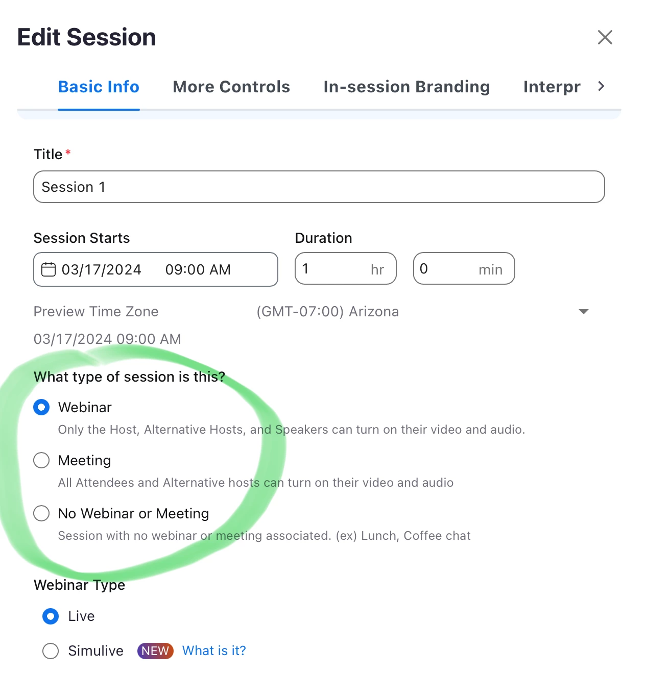

    Hi, @nutriat.
    A Meeting is basically open to everyone on the same way. Only Webinars have a separation of what I like to call “the audience” and “on stage”.  And in Webinars where the owner also has a Zoom Events “Unlimited” License, you have the option of having a pre-webinar “practice mode” (available to all webinars) or an additional mode of Backstage (only with the Zoom Events license).  If you really want all attendees to be able to participate equally, a Meeting is the way to go. In Zoom Events, all you have to do is change the Session type:
