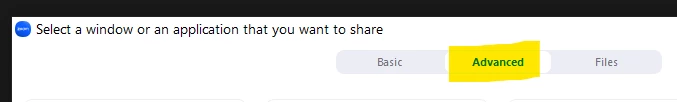

    2. On the pop-up window, click the Advanced tab:

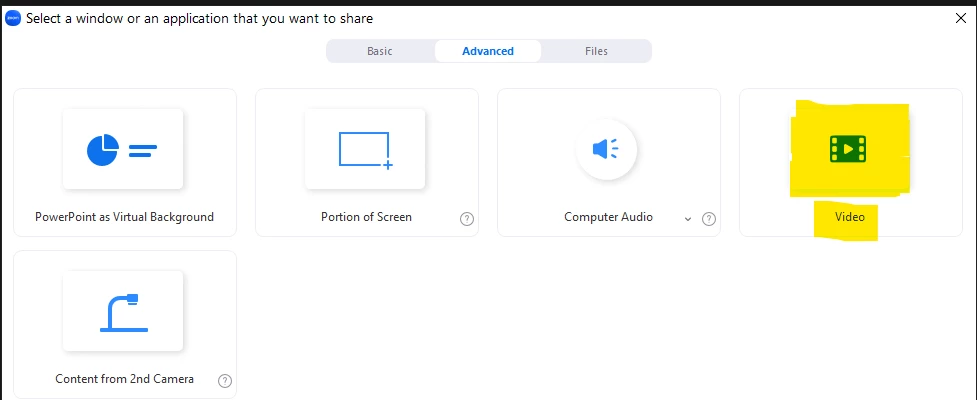

    3. Click on the Video option:
    4. Note that Share Sound and Optimize for Video Clip are automatically enabled:

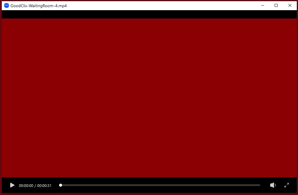

    7. Once you've selected the video, click "Open".  NOTE:  Now your video will be visible to attendees in Share Screen mode.  It will not be playing... only the first frame of the video will be visible.  You will then see the Video Player:

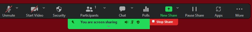

      and the usual "I'm in screen sharing mode" green-and-red floating menu bar somewhere on your screen:

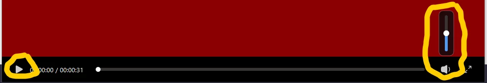

    8. Adjust the volume as needed, then click the Play button when you're ready for the video to start:
    9. The video player controls hide after a few seconds; they will re-appear when you hover over the window.  You can pause, move the slider forward and backward, and adjust the volume.  Your attendees will see the video in full-screen mode, like any other screen share; no need for you to expand the player to "full screen".
