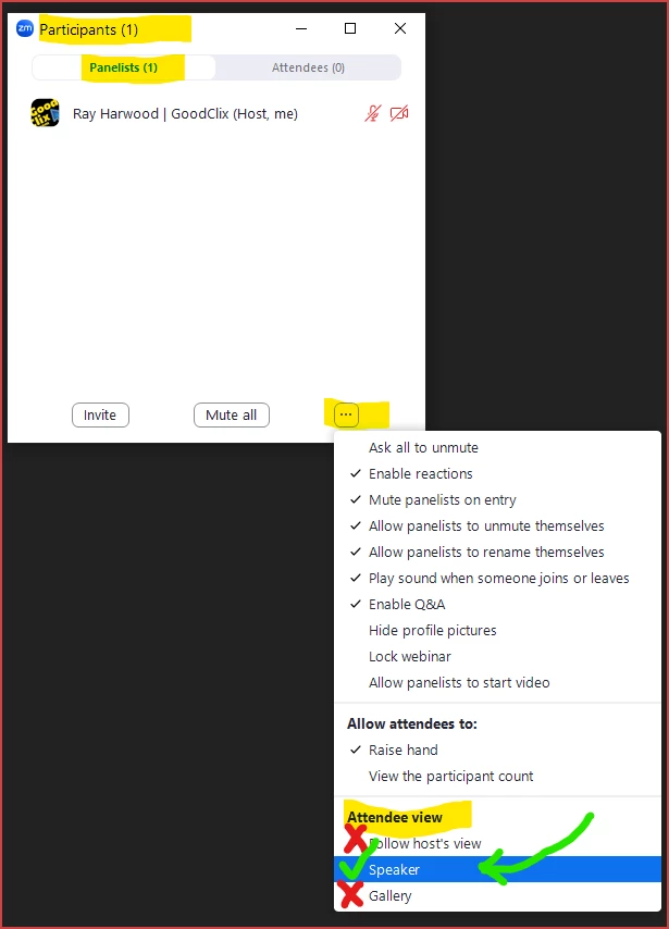

    The real trick is for the Host (or any Co-Host) to manually set the Attendees View to Speaker (or if there is screen sharing in process, set to Side-By-Side Speaker).  This is done from the Panelists window from the ... menu in the lower right (which does not show when viewing the Attendee tab, oddly enough):
    When Speaker (or Side-By-Side Speaker) is selected, the camera(s) being shown to the Attendees depends on whether or not you have any Panelists (or Hosts/Co-Hosts) Spotlighted.
    With no panelists spotlighted, the "active speaker" will be shown to the Attendees, and this will be switched by Zoom depending on who Zoom interprets is the main speaker at any time.
    With one or more panelists spotlighted, all spotlit videos (up to nine total) will be visible to the Attendees.  In your case, just do not spotlight the people you don't want visible.  Their cameras can remain on or off... doesn't matter for the Attendees - they won't see them.
