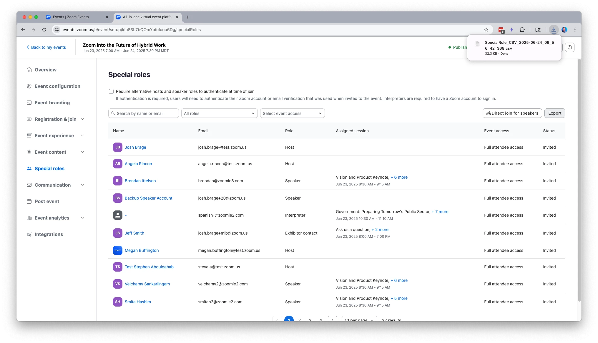

    Jun 24, 2025 3:58 PM UTC
    @hrodriguez413 Sure thing. under Special Roles in your Zoom Webinars & Events portal you can export a csv that contains all of your special roles join links - pretty common use case is to hand hold all of your speakers in that way.
    One other note with Zoom Webinars & Events - you can fully customize both the Speaker Invitation Email, along with the Special Role Reminder emails, so if you'd like to you can use those emails to send specific and thorough instructions to your speakers, along with join links... Hope this helps!
