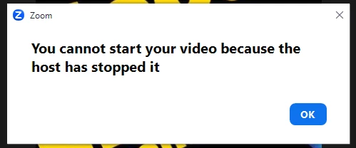

    I first thought, "Well, the Support article says people will have the same access to unmute and start video as they would in a meeting, so they can just do it."  I created a test webinar and tried it... and I was wrong.  Each time an attendee clicked the Start Video button, this message popped up:

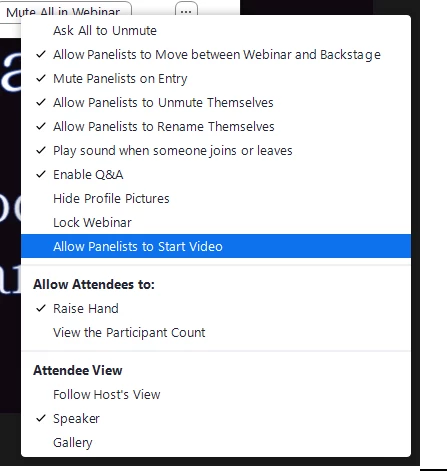

    And it took me several minutes to discover the "trick".  I looked everywhere for a menu option to "Allow Attendees in Breakout Rooms to start video" with no luck.  Then my eyes landed on the Participants window with the ... menu expanded:
    I enabled Allow Panelists to Start Video, and then when an attendee clicked Start Video, it worked.
    So a lot depends on whether the host initially has the Allow Panelists to Start Video set to enabled.  If so, no action is required.  If not, or if you get complaints about the pop-up error message above, check it and enable it.
