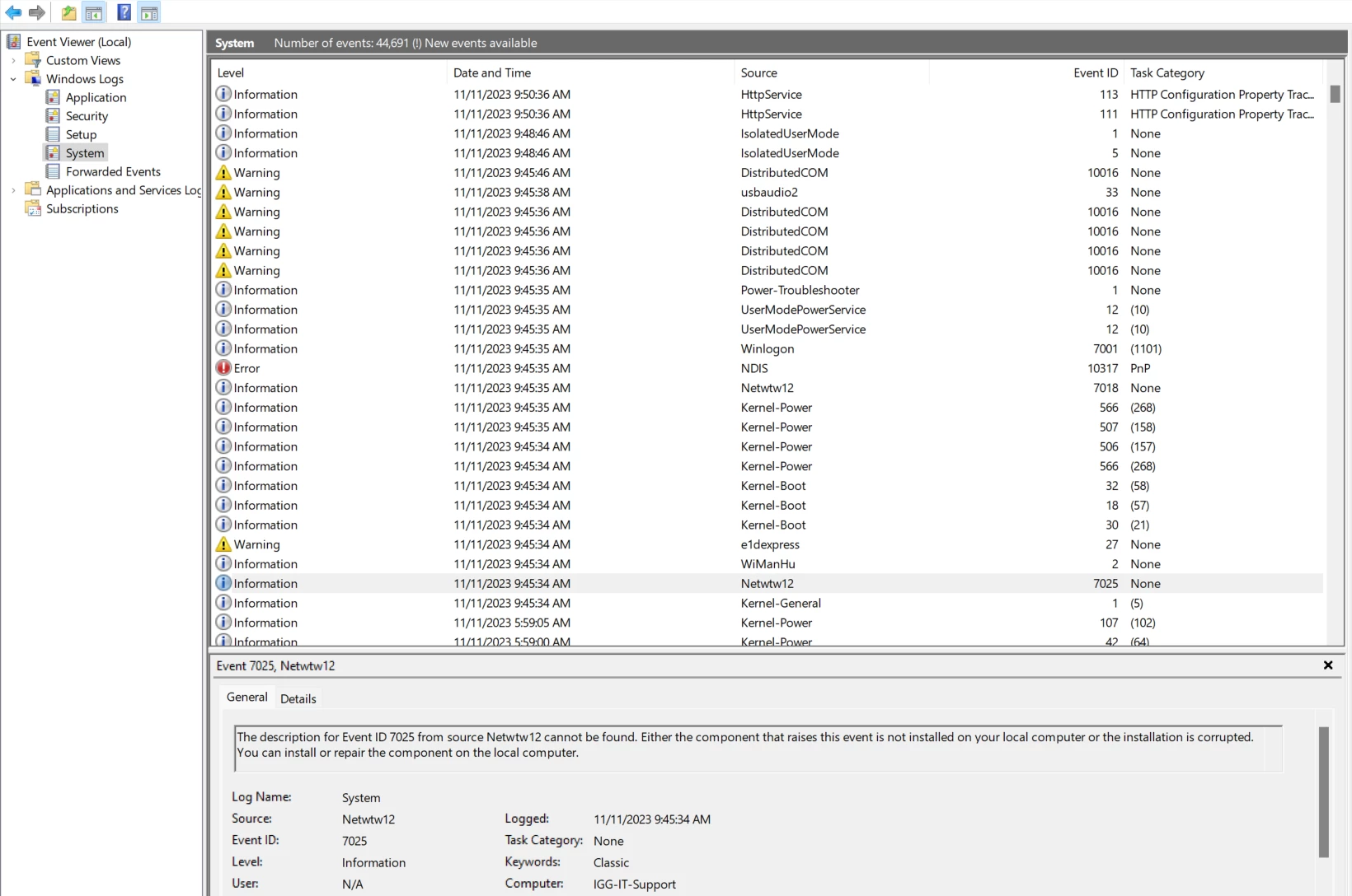

    Yesterday I looked at the Event Viewer for any errors and I've included them for you.  They are from the time period of the webinar.

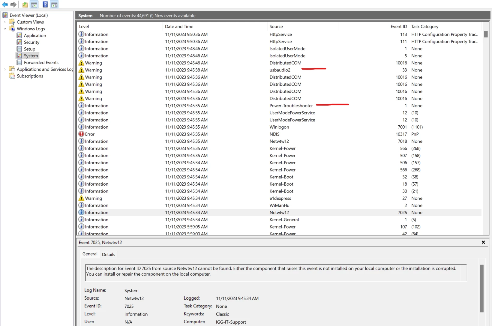

    Event ID 33 is the most concerning - can you relay the details?
    If, as I suspect, this is a USB audio issue outside of Zoom, I would start by testing other ports on the host device (as well as other cables) to see if the issue can be reproduced with those variables changed before diving into driver troubleshooting.
    Also, is the Behringer device running latest firmware?
