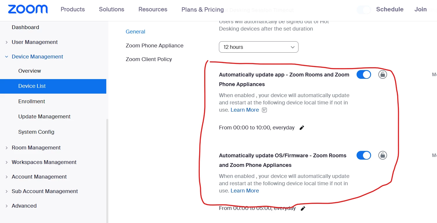

user12Author
Aug 3, 2023 8:18 PM UTC
Thank you for the reply but that did not solve my issue. I had set the Zoom Rooms to automatically update between the times of 12am-5am but our Zoom Room still got locked up because an update came out in the middle of the day.
When I say "locked up", I mean that when there is an update available, Zoom Room's displays the message "some of your zoom rooms devices need to be upgraded to join this meeting". So then, I go to update Zoom Rooms and it works just fine again.
The issue is that occasionally these updates will come out right before an important meeting and I can't constantly be monitoring the Zoom Room for an update. Is there a way to stop Zoom Rooms from NEEDING to update when there is an update available?
