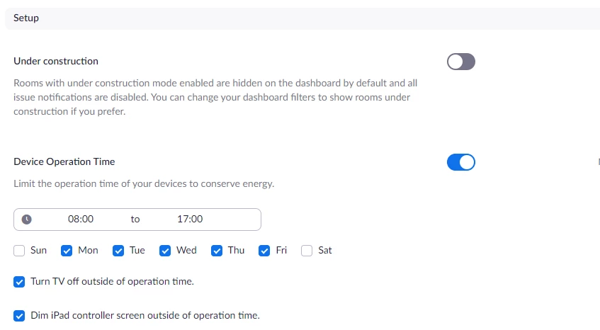

    Do you have a Device Operation Time setting?

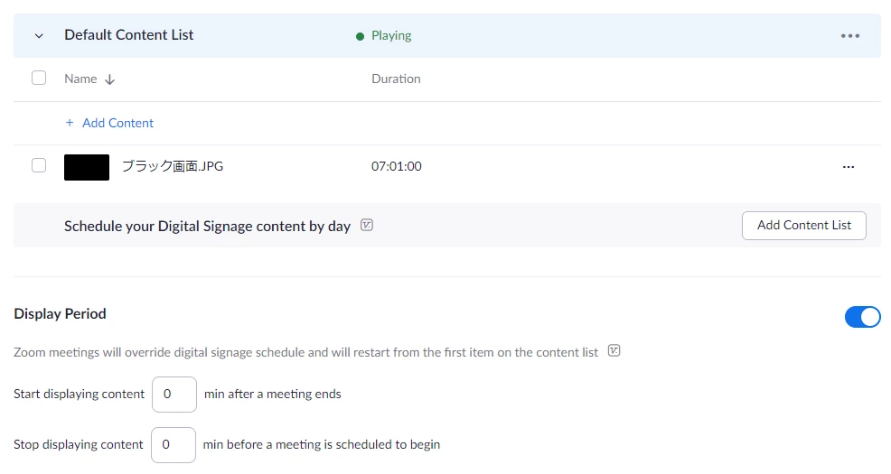

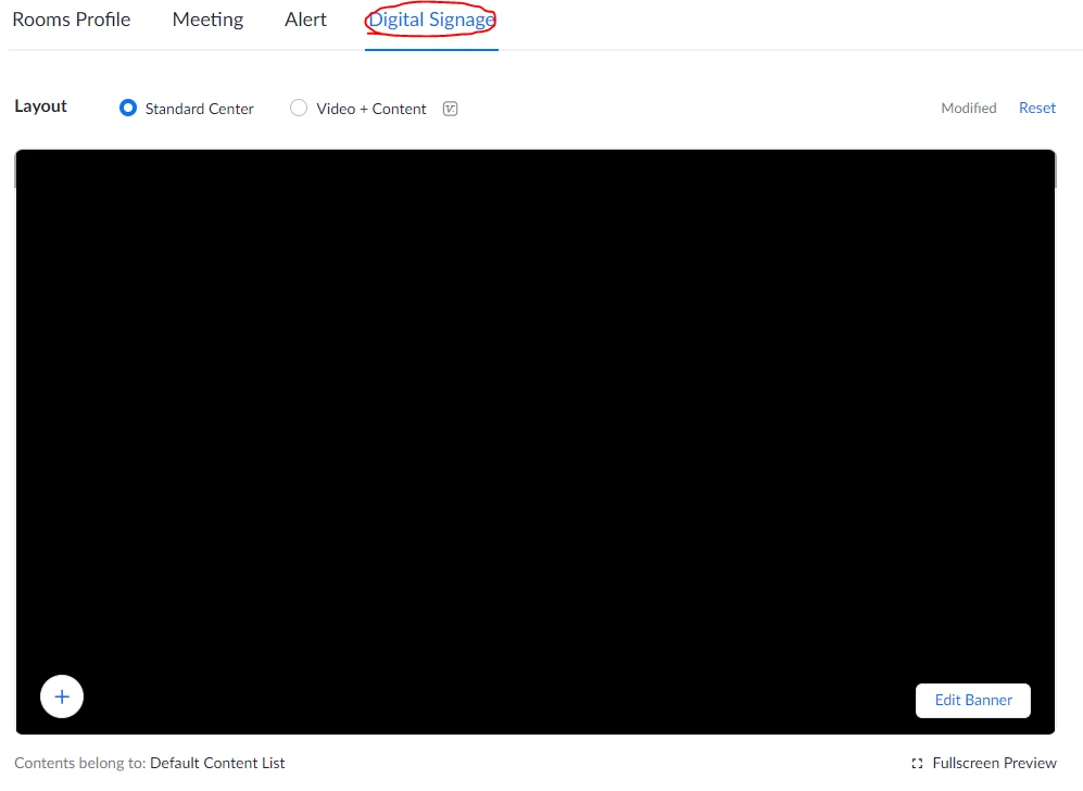

    Another way, you can use Digital signage.
    Registering black images as signage content and playing them back would prevent TV burn-in.

    I also have this issue. I have a Rally Bar system and a Rally Plus with Roomate deployed for testing at my company.  Ultimately Zoom overrides the devices CEC so the Logitech hardware cannot send the CEC OFF signal to your TVs. And Zoom assumes you want your displays on during office hours and does not give you granular controls.  such as turn off displays after 15 min regardless of office hours.
    I put in a ticket with Logitech and they came back with if the CEC test in the SYSTEM menu of the Logitech Rally system  works then the problem is the Zoom app.
