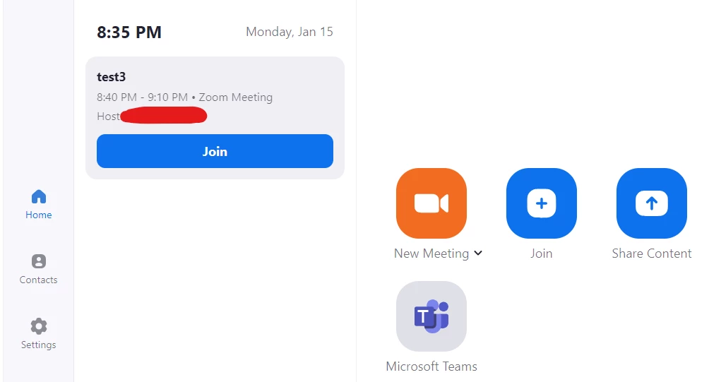

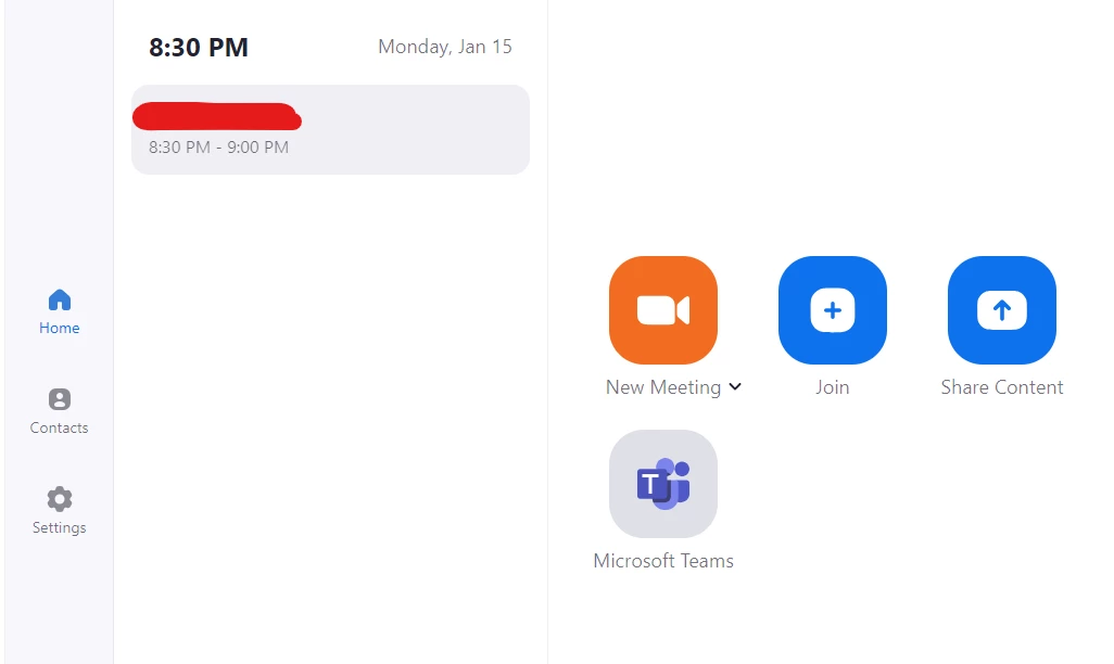

The issue is I do not see a Join button for the specific meeting.  Like I said, i can host a meeting from the controller no problem, I can join the meeting in progress if I send an invite *again* after the meeting has started, it just seems to be missing the join button.  See attached.
I looked into the calendar in Exchange, and it appears to be accepting the invite, responding to the sender, and deleting the email.  However, when it does this, it does not pull in the any of the meeting info, just the title.  The other calendar does NOT delete the invite, nor send a response, but all meeting info is there.
Is this a problem with setup?  Both are resource calendars with the same settings as far as I can tell.  Sorry, I inherited this
