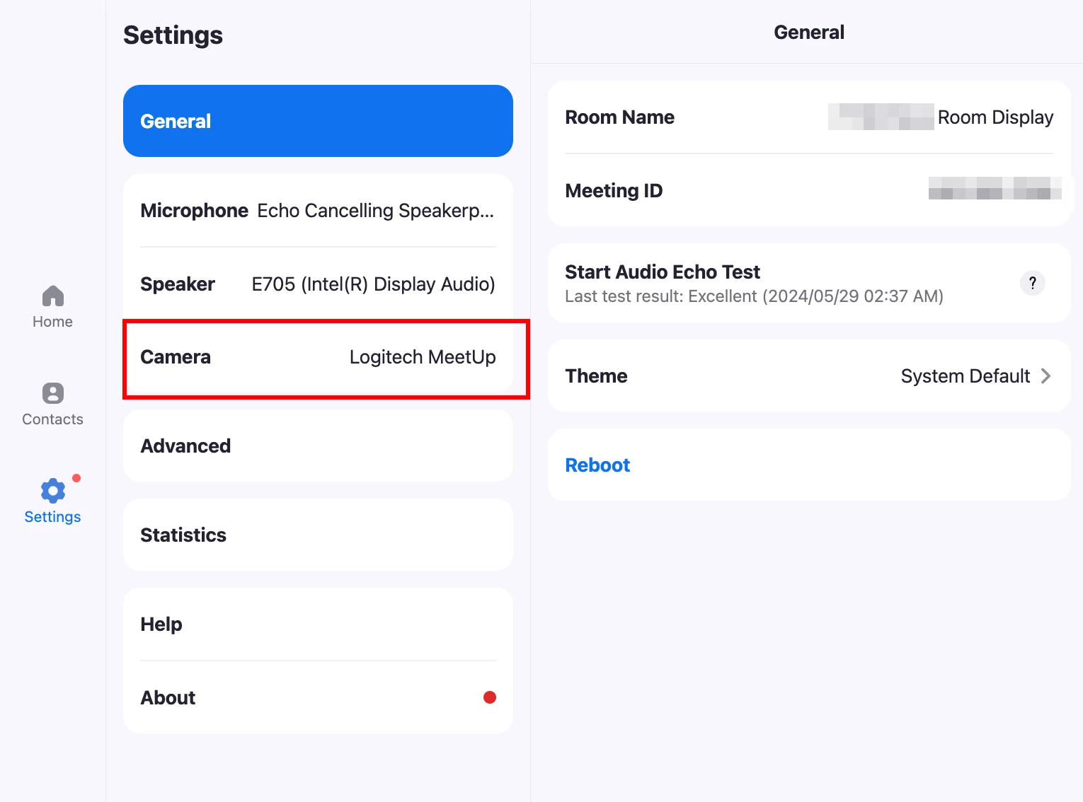

Hello @HAI3D ,
In my institution we operate many Digital Signage Only Zoom Rooms. In our experience,  we have never seen an option for camera control unless someone with a Zoom client licence pairs with the room using the "Sharing Key" displayed in the upper-left hand corner of the screen.
I just did a quick test of a system running in Digital Signage Only mode (Windows 10 , 64bit) Zoom Rooms client version 5.17.7 (3724) , 64bit.
There is no camera control button for this sign, although it does have a Logitech MeetUp attached.
(see screenshot)
The only thing that I can think of that may have caused the "Camera Control" button to be present is that the "Room Type" was incorrectly assigned as a full Zoom Room.
¯\_(ツ)_/¯
I hope that this provides the information you need, reply if you have any further questions. Otherwise, consider marking this post a "Accept as Solution" so other Zoom Community members may find this solution as well!
