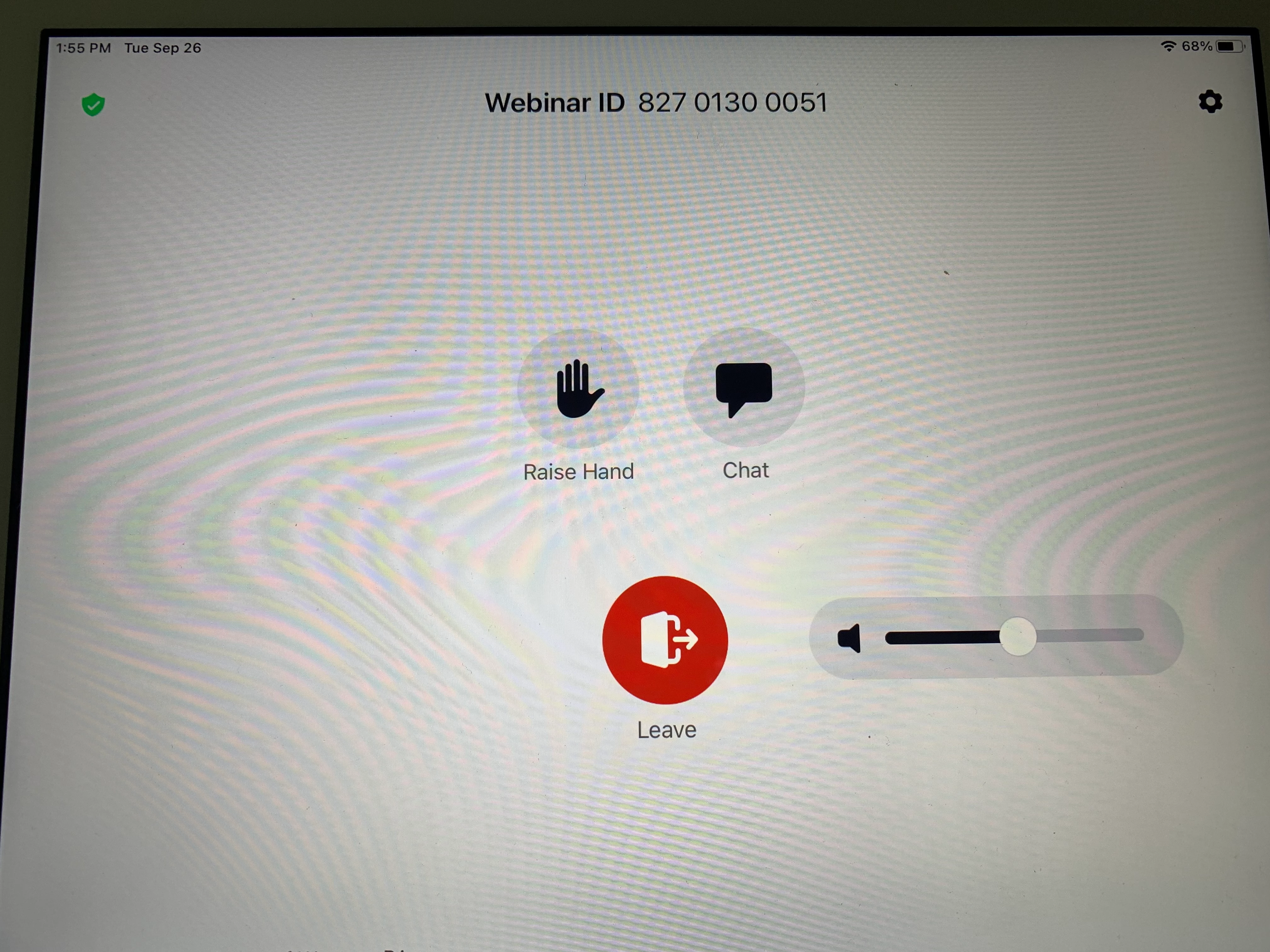

Hi, STCAWP.
From that screenshot, it looks like that the Zoom Room joined as a normal attendee. If you want it to have further control options, either promote it to a panelist or co-host, invite it as a panelist or set it as an alternative host.

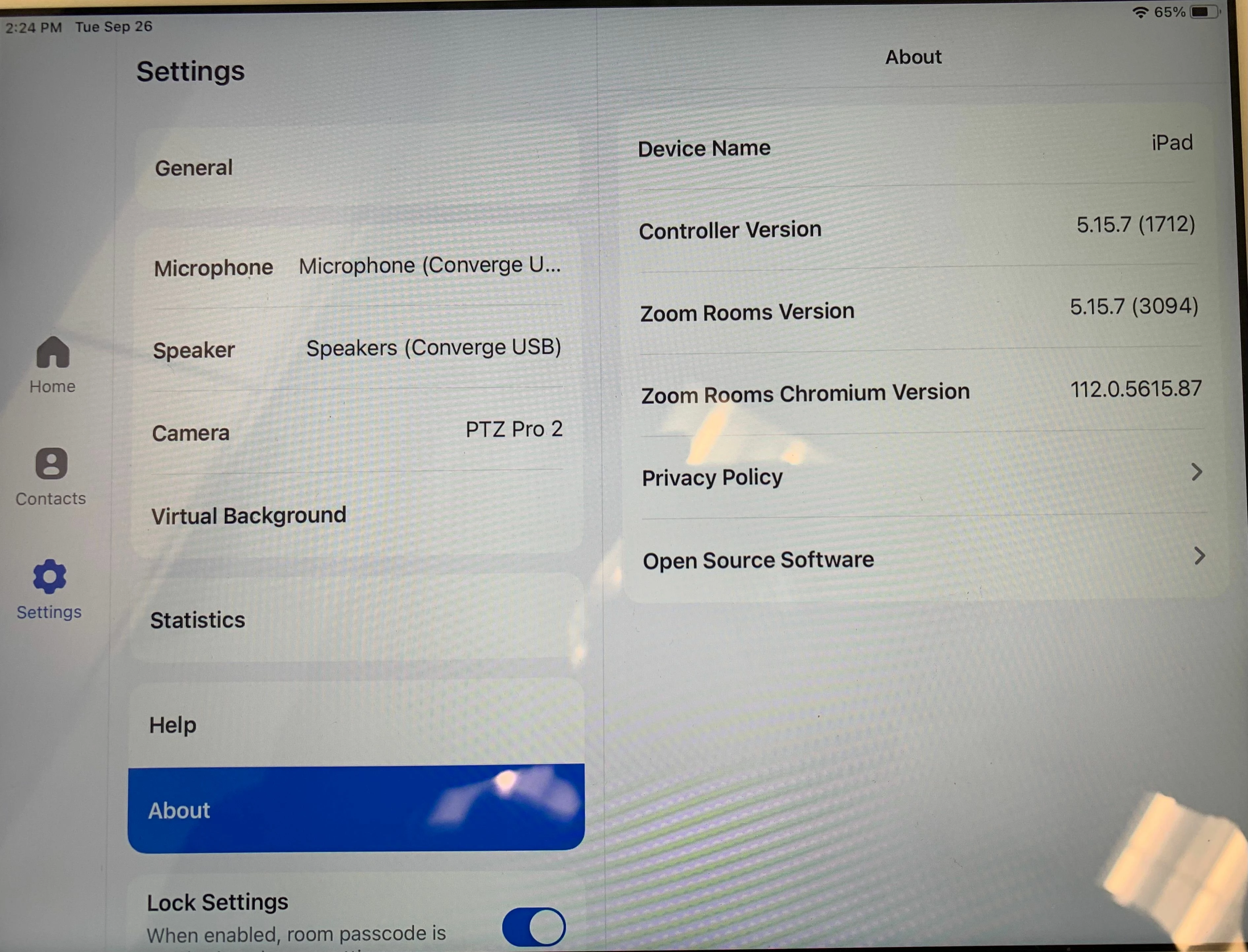

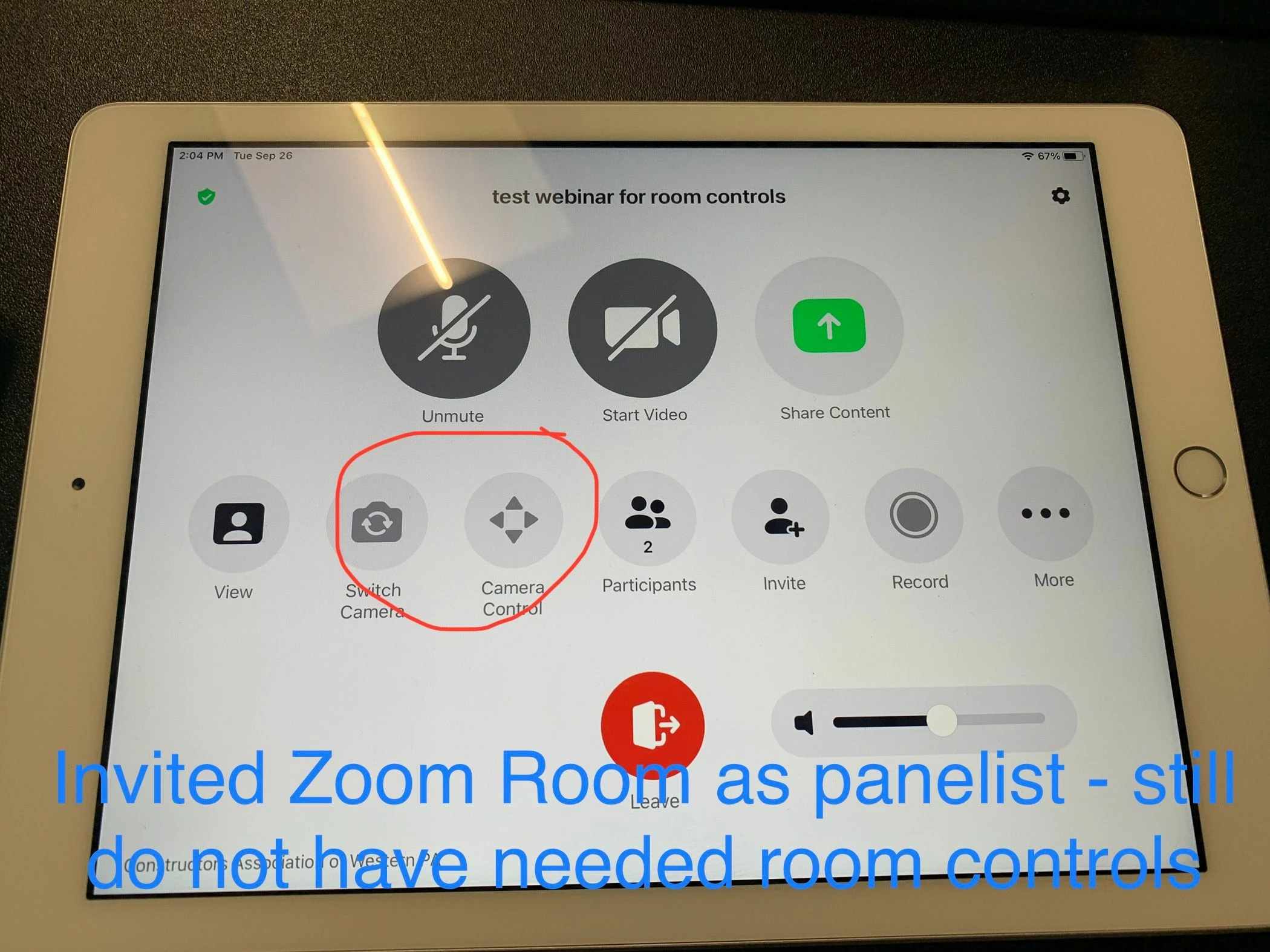

Unfortunately, Zoom support has not been of any help.  We have tried promoting to a panelist and still no controls!  I've sent multiple screenshots to show what the issue is.  On our end, nothing changed - then suddenly we can't utilize the Zoom Rooms Controller for a webinar.  It makes no sense.  I did have to ask our account manager to escalate the issue.  I'm hoping higher-up support may understand the problem.  This has taken up 2 1/2 weeks of my time as well as the assistance of our outsourced IT and AV professionals, and they haven't been able to figure it out either.

As shown in the additional screenshots, nothing is working.  It is only an issue when facilitating a webinar.
