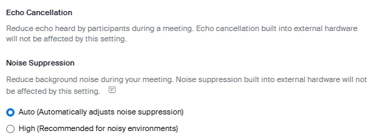

You can also attempt to turn off Echo Cancellation and Noise Reduction, but most ZR Appliances (including G7500) will try to flip these right back on by default:
