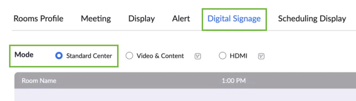

    Hey AmericanMagic,
    Even with 2 displays, there will be no delay and no image will be out of sync as it will be using the same source to showcase the same content. You will be able to set the timing yourself.
    In order to have both TVs showing the same content, make sure, that you select "Standard Center" when setting up the mode. So long as they are connected to the same Room, it will be simultaneous.
    I hope that makes sense! Let me know if you have any other questions 🙂
