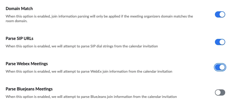

    Hello @webextozoom,
     If you go into your Rooms admin portal and then to your calendar integration page and click edit on the calendar integration that you have with Zoom and the Webex Kit (assuming that you are registering the room or at least provisioning the room through Zoom) then you can go in that setting and turn on (enable) Webex parsing. This will allow Zoom to recognize in the location field of the calendar event that the meeting is a Webex meeting and parse the URL correctly to your Room.
