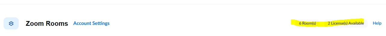

Hi Ray,
Zoom Rooms require a license separate from Zoom meetings as it is a different service. You can verify if you have an available license in the Admin portion of the Zoom web portal. Under "Room Management" click on "Zoom Rooms" and look to the far right of the screen in about the middle height-wise, you will see the number of active rooms and licenses available (as seen in the screenshot below). If you have available licenses you will need to generate an activation code and sign into the Zoom Room using that code then pair the controller by using an activation code as well. Both devices need to be on the same network to communicate, so if your tablet is on wireless and the wireless vlan can not see the vlan the controller is on they will not work together.

Hi Ray,
